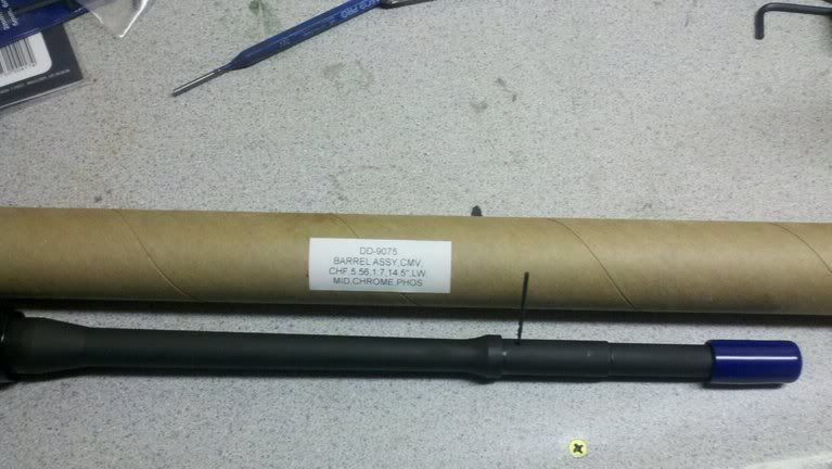

    Daniel Defense 14.5 Mid Length Gas Port Size .076
    A #48 drill bit fits nice and snug in my new barrel.
    Looks like the #48 is .0760".
    See the link below for drill bit sizes.

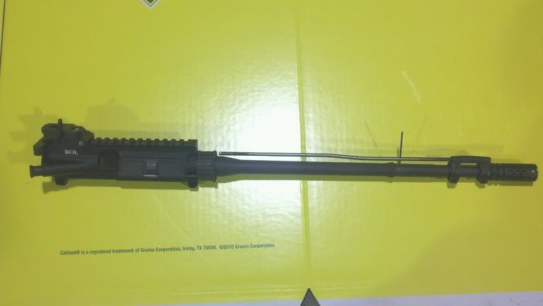

    BCM 14.5 ML/LW Gas Port
    I just removed the FSB off my BCM. I used the same drill bit #48 which is .0760" fits just like it did in the DD barrel. Sorry crappy pic.

    Quote Originally Posted by archad View Post
    That's off a tiny bit from what DD says their port size is for that barrel but probably not enough to matter. I can't help but wonder, however, what it would gauge at vs. just sticking a drill bit in.

    The drill felt the same in the both barrels. Maybe its off a .001" or two. The DD barrel gas port has more a chamfer. The BCM is more like a straight 90 degree if that makes sense. I guess to be exact I should had some pin gauges. Anyway my BCM 14.5 middy shoots real smooth and I expect the DD shoot smooth and maybe more accurate since it CHF.
