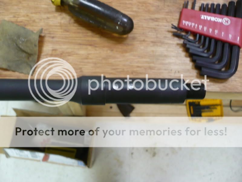

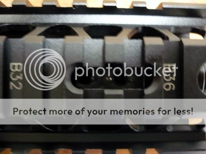

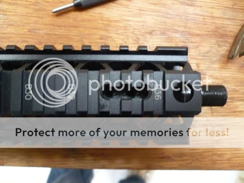

    I am not saying that I don't like the monolithic. I actually like my Mega SBR very much. The issue that I have with that particular upper is that you have to set the gas block AFTER you have installed the barrel to the upper. You really have to pay attention and get everything perfect so the gas block never comes off. There is also no way to pin the block on.

    Thanks for the pictures. As I am an amateur, could you please explain the perfection needed for ensure the gas block never comes off?

    Quote Originally Posted by luvjetz View Post
    I would dimple the barrel where the gas block screws will sit on the barrel. Use a good drill press.
    Rockset the threads on the gas block bolts.
    Stake the gas block bolts.
