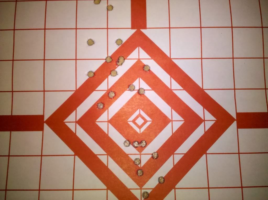

    Ok....... so update and new question. I'm kind of struggling zeroing this thing. Is the bullet impact supposed to be covered by the tip of the sight or slightly above the sight. At 50 yards I aimed at 2 points and got 2 results. The top group is aiming dead center of the diamonds. Bottom group is the lower tip of the large diamond. Again not much time to shoot and the groups still arent impressive. Only my third time seriously trying to shoot a rifle though.[IMG][/IMG]

    Read your post again to edit my response. You aimed at two different points and hit accordingly. There is no issue here. Not a great group but they make sense- right? Fairly consistent. So Mark addresses your question below.
    You can choose if you like a 6 o'clock hold or a dread on hold. My eyes prefer a 6 o'clock, but most guns are sighted to cover the target you are shooting. So I will often shoot low. I am not the subject matter expert on irons, pretty bad actually so I am sure someone can help more.
    IMHO, Its your choice with your irons. Just know what you chose and practice that way.

    Quote Originally Posted by TylerD View Post
    That Zero would be TOO HIGH for me. I zero a carbine's irons so that I hit about 1" low at 50. That way I have an effective 100 yard zero.
    I only do this because the sight radius on a carbine is such that I struggle to see the target at 100. A rifle, I just zero at 100.
    If you're wanting a true 50 yard zero, you need to raise your front sight post. Where you put the tip of your post should be where you put a bullet hole.

    So then what I need to do is turn the sight post to the left until I hit lower correct? And this is my first rifle and I'm shooting with M855. Should the groups be tighter than this at 50 yards with irons? I'm just trying to figure out if my sight manipulation and picture are counteracting one another. Maybe I should add that I had turned my sight post 1/2 turn to the right at 25 yards to hit where it was in the previous pictures. To obtain these results I ended up moving the sight post left 1/2 turn. I did this time use the smaller ap. I did shoot from a bench with the mag touching the table and supported the end of the barrel with my range bag.
