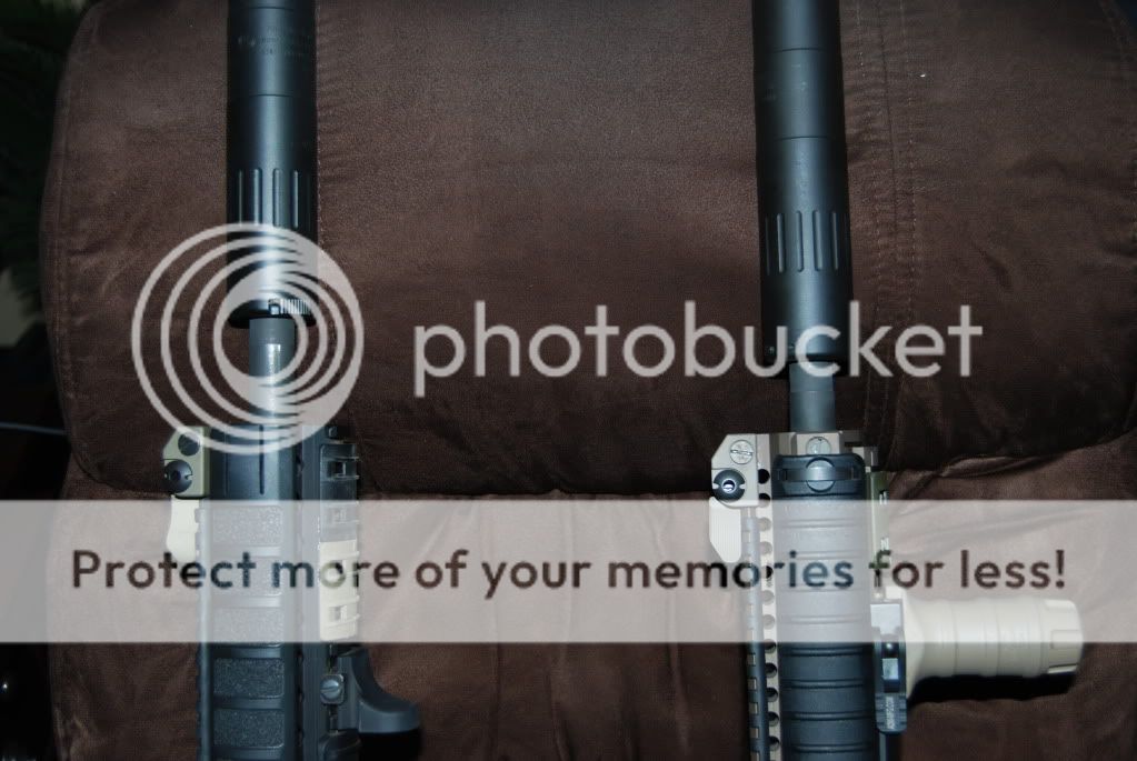

    Per your request on my PM.
    11.5 and 12.5 with 10 inch rails with m4-2000's
    I use the Double chamber Brake on the 11.5 because I run it suppressed all the time. And the Brakeout on the 12.5 because I pull the can off sometimes.
    If you plan to pull the CAN off, get the Brakeout, because the double chamber BRAKE is a brain thumper even to the shooter. If your beside it- Brain damage.
    I am happy enough with both my rigs.

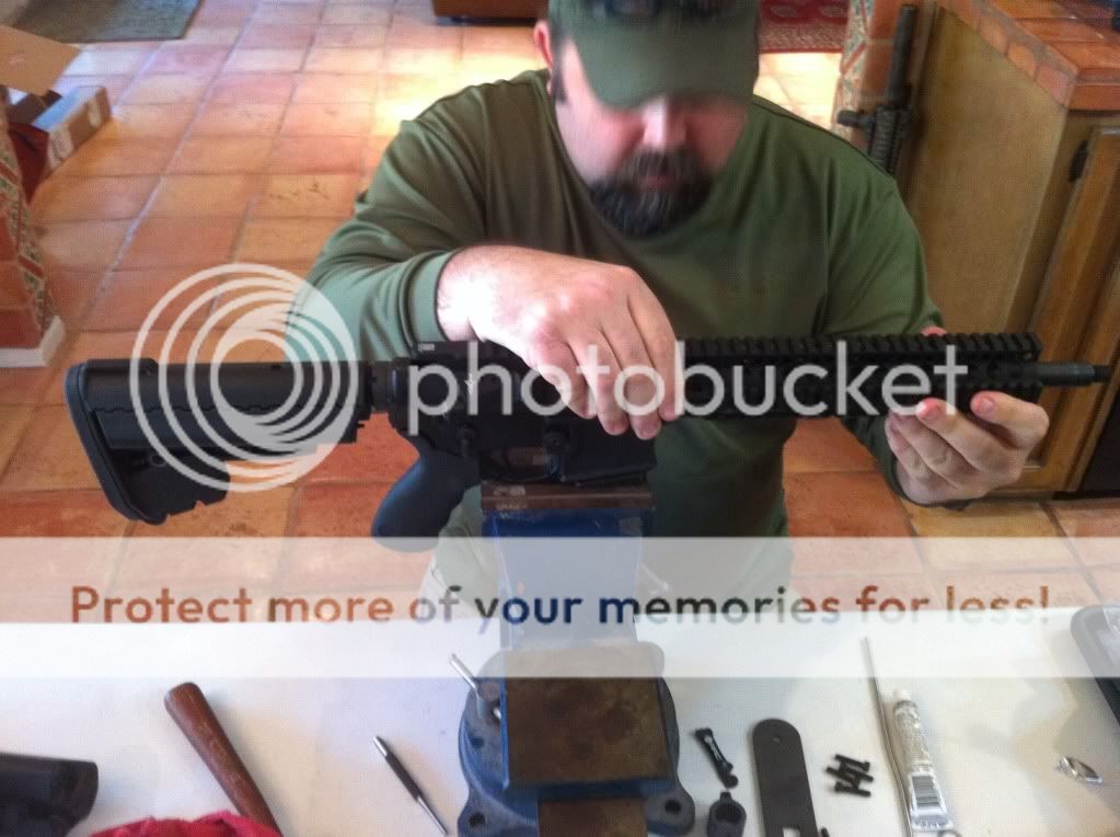

    Where have I seen those two homos before? They look familiar.
    Quote Originally Posted by Pappabear View Post
    I think you might put a wrench to that metal mania.
    Thats the BCM 12.5 with Vltor upper, DD RISII, switched lowers in its birthing process. You painted that lower with that 14.5 Noveske barrel.
    After I took that picture above I changed those ugly ****in panels on the 12.5 to those Larue clips. Much better.

    Cool, thanks for taking the time to post the pics and info, Papabear.
    Those are some nice looking rifles you got.
