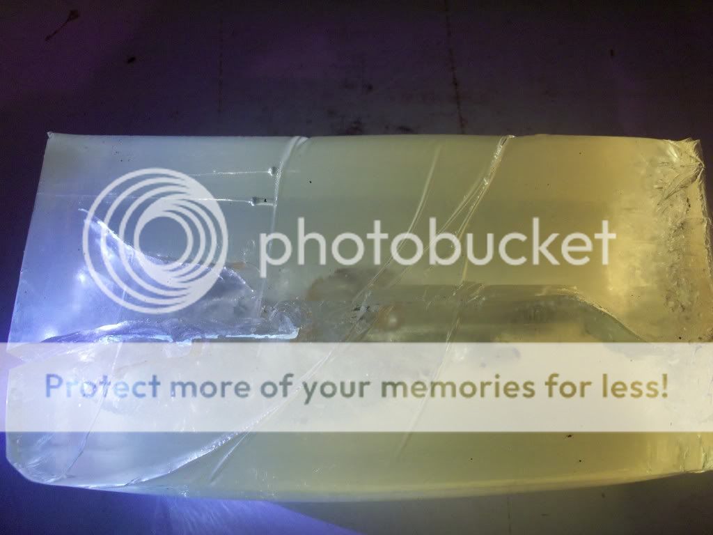

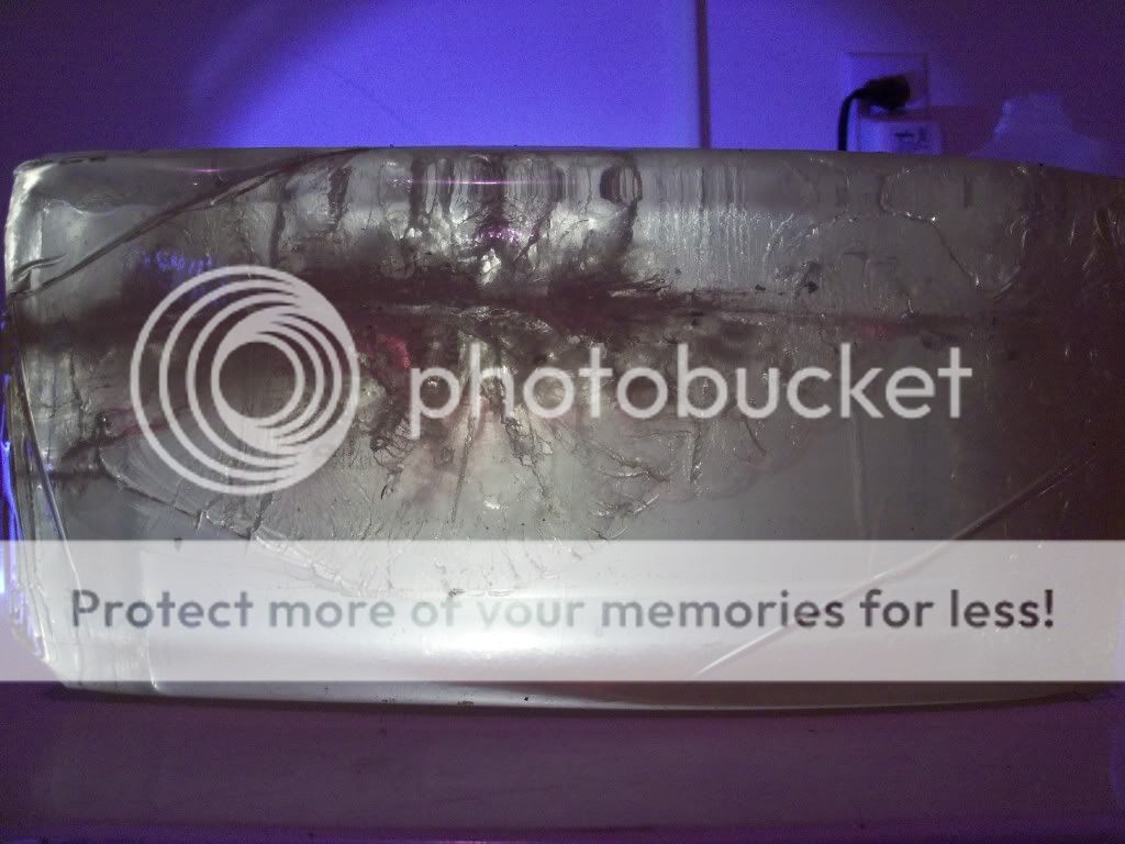

    Anyway, the first thing I learned is that a 6"x6" block is not big enough for rifle bullets. It didn't help that I failed to hit the perfect center of the block (didn't compensate perfectly for the close range) but I also think the max crack diameter for this round would have exceeded 6". As it stands, I don't know because the crack extended beyond the edge of the gel block. I used the 6x6 block because gelatin innovations sent me the 6x6 kit accidentally and told me to keep it so I figured I would try that one first so if I royally screwed up I wasn't really out anything. Here's what I found:
    Neck Length = 0"
    Max Cavity = 5 1/8"+
    Length of Cavity = 12"+
    Penetration = 12"+
    BB @ 650fps penetrated 4 1/8"
    (Most say + because the crack blew out the side of the block, as you'll see in the photos below)

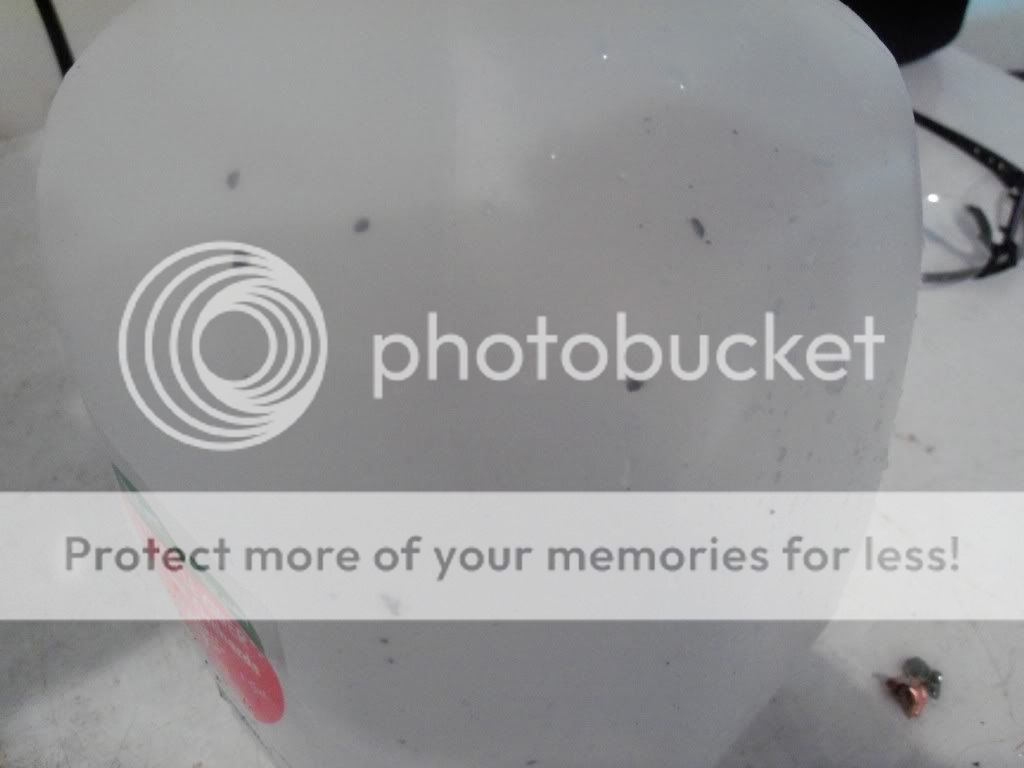

    The bullet fragmented and you can see frag along nearly the entire cavity. I caught the bullet after it fully penetrated the block using water filled jugs (I was hoping it would penetrate more than 12" so I anticipated this with the short block) and it had a separated jacket and core. That said, the jacket and core, as well as a lot of frag, ended up in the jug.

    Right Side
    Top

    Frag still stuck in jug (it was still wet and they wouldn't pour out)

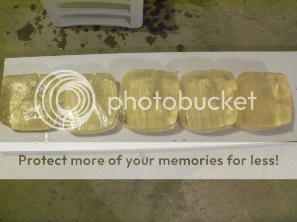

    Dr Roberts, I went back and sectioned the bock at approximately 2.5" intervals giving me 5 slices. I then measured the cracks at true length instead of estimating by looking through the side of the block. Here's what I got for actual measurements:
    0" - 4 3/16"
    2.5" - 5 1/4"
    5.0" - 5 5/8"
    7.5" - 4 1/4"
    10.0" - 2 7/8"
    12.5" - 2 1/4"
    My initial measurements in the first post were from holding a tape measure up to the side of the block, which of course didn't measure the largest actual crack diameter. That didn't account for the hypotenuse, just 1 side of the triangle and an estimate at that.
    Which measurement is the correct one to report? I want to make sure I'm posting accurate information. If the numbers I got after cutting the block are correct, this round may have some promise.

    The one at 2.5" is probably closest to the actual max TC, however since your block was so small, the actual stretch may not be correctly derived. Keep in mind that there is a standardized methodology associated with crack measurements.
