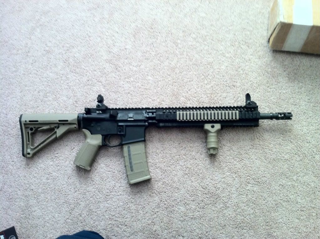

    It was tough, but I waited until I had all of my parts (minus sights) to begin putting the gun together

    I've only had her out once. Shot 20 rounds of Federal 5.56 55 grain, 100 rounds of Federal .223 55 grain and 40 rounds of American Eagle 55 grain. All performed flawlessly with a problem.
    Recoil is almost non-existent. The rifle seems fairly light to me but don't have an exact weight. True to what I read the comp is louder than a standard flash hider. With ear plugs in I didn't really notice the noise so much as the concussion produced when fired. Overall I'm pleased with it and don't regret getting the comp. I played with the rear sight a bit and got it on target at 50 yards but I haven't truly sighted it in yet. Just wanted to sling some lead down range
    I know I could have pretty much bought the same gun from BCM fully assembled and it would have been much cheaper. But building was half the fun for me and I learned a lot about the platform in the process. I could have built a much cheaper gun but I didn't want to build another gun just because my first one wasn't exactly what I wanted and I was too cheap to spend money on quality parts. In the end I know I ended up with a quality firearm that has all of the features I was looking for.

    Good first build. Well done. Assuming youre right handed, reverse the TD grip's AmDef QD latch and your grip will magically be much more comfortable.

    Quote Originally Posted by Pax View Post
    My only complaint with the Condor rifle case is that the weapon retention straps in the large interior pocket are sewn to the edges of the pocket. I prefer cases with webbing matrices throughout the weapon pockets' sides that can be used with Velcro keepers to secure the weapon, as they actually hold the weapon in place. Also I dont know the make on the zippers on my Condor. They havent been an issue yet, but if I can get YKK, I prefer to.
    Thanks Pax, I was actually unsure of which direction to put it. There was no indication in the packaging that I could find. Originally I had it on the opposite side than in the pics. After searching the net, all of the pics I had seen showed it like I have it currently mounted so I assumed that was the directed it was supposed to be. I'll try it the other way and see how it is. And yes I agree, the Velcro keepers would be nicer if they didn't attach at the edges. But for 60 bucks I guess you can have it all.
    Jan 2011
    581
    Oh I just meant flip the QD lever around, not turn the whole grip. But. I guess that works too. Whatever floats yer boat.
    Unlock the lever and pull the bolt that also serves as a locking block on the rail just far enough out of the non-lever side of the grip to allow the bolt head to spin. Unscrew it slowly until you can shove it back into the grip enough to allow the QD lever on the other side to clear the grip in a 180 degree rotation. Put the lever in whichever position tickles your fancy and retighten the bolt, checking it with an in spec rail to ensure proper fit.
    Rotating the QD lever instead of the entire grip will allow you to keep the lever on the left side of the weapon, the side more naturally accessible to right-handed shooters. But. This is the only possible benefit I can see to it. I suppose if a situation dictated that you NEEDED to ditch the grip to rest the rifle and take a long range shot, perhaps this might help. But. Eh.
    Ahh, I gotacha. I'll play around with it some, see how I like it best. Thanks for the advice.
