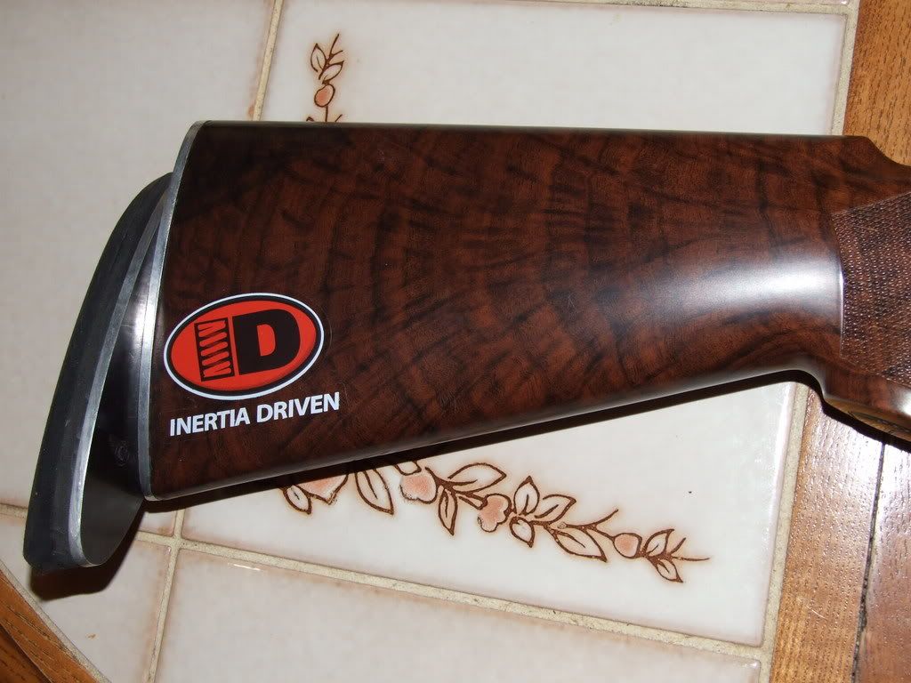

    The issue with the canting of the stock would not pose a serious issue. Depending on how you shoulder the weapon, it might actually fit better. I shoot skeet with dudes that cant the butt plates a bunch (pic). It may be a better fit on you.
    However, the OCD in me has "tapped" the stock straight. Normally, there is enough play in the end plate (at the key and the indention into the lower) to allow it to go straight. If not, you can remove the endplate and carefully file the side of the key that is not allowing it straight just a smidge. This should allow it to go straight.
