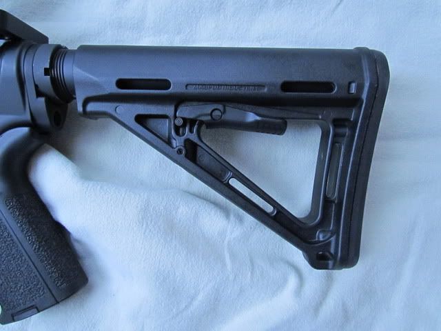

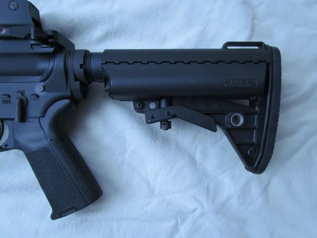

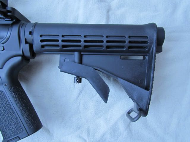

    Here are some pictures of the buttstocks in their fully collapsed position with the A5 receiver extension:
    Vltor IMod:
    Magpul MOE:
    M4:

    Quote Originally Posted by jwfuhrman View Post
    ACS, CTR and MOE Stocks will collapse completely.
    Quote Originally Posted by SteadyUp View Post
    Magpul MOE:
    That's not collapsed completely...
    M4:
    This is really helpful...

    The EMOD is a bit longer than the IMOD, but I'm not sure if it would collapse completely.
    I don't have any trouble mortaring with the IMOD, but I have to make sure that the the top rear of butt plate hits the ground, otherwise you *can* rip the rubber pad off of the stock (the IMOD has a hole at the end of it, just like a regular M4 stock, that is covered by the butt pad).
