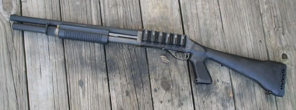

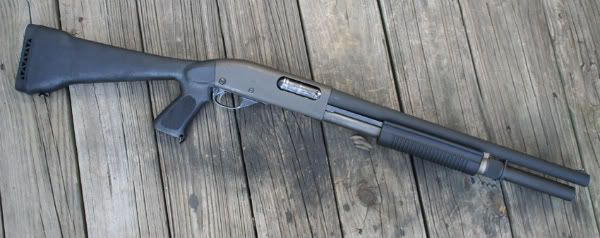

    Quote Originally Posted by Buck View Post
    As I have taught this class for years and seen hundreds of thousands of 12 gauge rounds go gown range out of tactical shotguns, this is a topic that I feel very comfortable talking about…
    Without a doubt I would recommend a Remington 870P… The Police marked 870s are assembled on a completely different assembly line than the Magnums or the Express guns. The quality control is much higher on the Police 870s and they use better quality springs in the action…
    The semi auto guns are nice, but the 870Ps are work horses…
    Here is the configuration I would recommend:
    20 inch barrel with rifle sights and 14 inch barrel with rifle sights so you can change back and forth as needed…
    Meprolight makes a factory style, set of night sights that works very well. I do not care for the trijicon “pistol” sights.
    Scattergun just glues their sights on with epoxy, they end up falling off and the front blade is way too wide…
    I like the vang comp magazine extension with the solid fixed front sling swivel the best. It is machined from solid bar stock. The factory Remington and the Tac-star ones work just fine too… Avoid the scattergun magazine extensions at all costs… They are silver soldiered together and with hard use they are prone to separating and launching the extension down range making your shotgun a single shot.
    If using the Remington or tac-star magazine extension the scattergun stand alone fixed front sling swivel is the best. The GG&G ones do not fit correctly…
    Be sure to keep the factory nut so you can take off the magazine extension for use with the 14 inch barrel. And be sure to use the long spring with the extension and the short one with out.
    Some of the newer production guns have a pressed in set of ears inside the magazine tube. Be sure that these are removed or pressed out prior to installing the extension or the spring / follower will not move freely.
    Scattergun does make a nice high-vis lime green plastic magazine follower with a easy to feel button.
    The Surefire dedicated light fore-end is the king of the plains, but be sure to put the limiter on the pressure switch to avoid turning the light on every time you rack the action.
    The factory safety works just fine and does not need replacing… The extended models offered by several manufactures are a solution looking for a problem…
    Tac-star six or four round side saddle…
    Fixed rear side sling swivel plate between the rear of the receiver and the stock
    Speed feed youth length pistol grip stock WITHOUT the internal magazine. The magazine collects junk and the rounds are not held in securely enough. They either fall out or get hung up. The shorter length stock is the correct length of pull for most shooters using a tactical shotgun. NOTE, the washer provided with the speed feed stock is junk. With any hard use it will turn into a soup bowl and the stock will become lose and start to bite. Go to your local hardware store and purchase two thick steel washers and a split washer to sandwich between them. This is the best fix for this problem.
    I recommend a padded VTAC attached to the front and rear fixed side sling points or the Blueforce if you prefer. It drives just like your carbine…
    I do not like butt cuffs… With any vigorous use the rounds always fall out and leave a trail of shotgun ammo like Hansel and Gretel…
    If you think you will need more ammo, I highly recommend the California Competition Works 12 gauge tactical stripper. Order it directly from CCW and ask for the black nylon cover and the Bianchi M9 holster belt clip so you can put it on or take it off without having to remove your belt.
    Put it all in a short Pelican hard case and you are ready to kick doors with the best of them.
    As to ammo I really like the 2 ¾ Federal TAC 9 OO buckshot and the 2 ¾ Winchester Ranger 1oz low recoil slugs. You only lose about 200 feet per second with the low recoil slugs but the difference in the muzzle flash is dramatic when firing in low light conditions.
    Just my .02
    Buck
