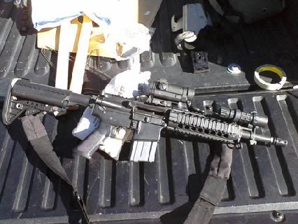

    Yep. Comp M4. It just sat around too long with a cheapo battery inside it. Not the Aimpoint's fault.

    It's just a loaner.... The shocking part it that there's a LaRue mount... ON MY GUN!!!
