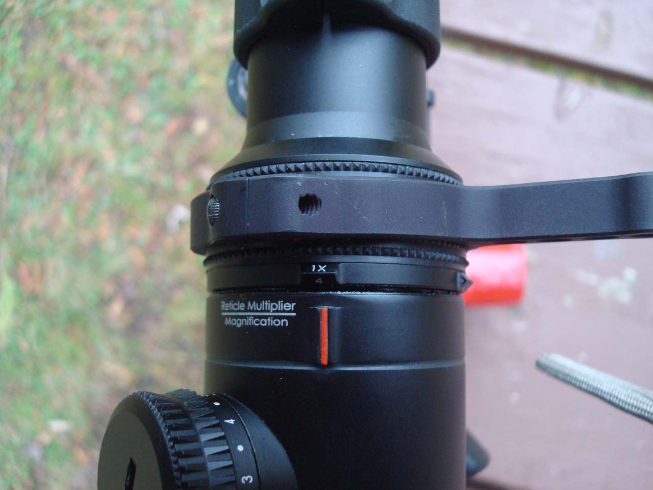

    The magnification ring is marked with several power settings, as well as a "reticle multiplier," which provides an integer to allow calculation for bullet drop or range while using the reticle subtensions at different powers. Again, something I will probably never use, but it's a thoughtful feature that doesn't add weight or take up space. Another nifty feature is the raised magnification indicators - visible without having to move your head from behind the rifle. A fiber optic rod makes it easy to see your magnification setting. I found the ring itself to be a little stiff to adjust - especially while wearing gloves. Good that it will stay put, but not especially fast. I added an MGM throw-lever which is fairly low-profile, and makes changing the magnification on the optic much faster.
