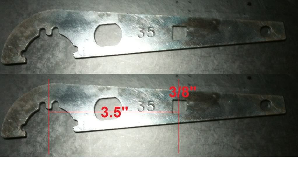

    The military tool has a 1/2 hole for use with a torque wrench... That by it's self should immediately clue you in that the spec is in ft/lbs not in/lbs. I modified my MI industries castle nut tool for use with a torque wrench. Because I couldn't make the hole as close to the head of the tool as I wanted, I used a crow's foot torque calculator to find the right distance to get within the 38-42 ft/lbs spec, and use a whole number. I use the torque wrench set at 35 ft/lbs, and I marked the tool so that I don't forget...

    olekennyroy great idea. I had always wondered about doing something like that. If you don't mind me asking what did you cut the hole with?

    I used a sharpie to draw the square. I drilled 5 1/8" holes, 1 in each corner, and 1 in the center. Then I used a 3/8" to open up the center. I followed up with a triangular file to form the sides. I threw the wrench in the oven while cooking shake and bake chicken, 400* for 45 minutes, to harden it up a little.
