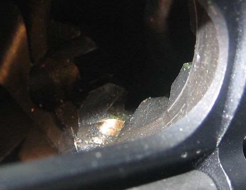

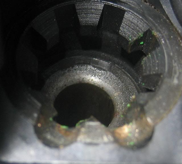

    My M4 feed ramps are apparently not machined right.

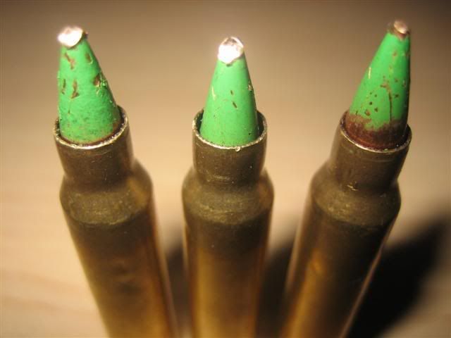

    9/10 rounds are getting pushed into the casing, and upon further inspection, i *think* thats what's happening.
    Sorry for the bad pics...
    this is what the rounds look like after trying to feed into the chamber:

    We just had a problem similar to this, we were trying to run a rifle class in our indoor range and we used Frangible Ammo (Sorry I do not know the maker). After NUMERous malfunctions, where rounds would not feed and it seemed like they were crashing into the receiver and not feeding. By the way this did not happen with Federal XM193 in the same gns on the same day in our single lane rifle trap. When we compared the case length of the crappy non-feeding frangible ammo to the XM193 I noticed the XM193 cases were longer. I do not know how much longer, but they were longer at least an 1/8".
    TRY this. Compare your above ammo to a known QUALITY not reloaded ammo.

    ammo is M855 and when checked against other rounds, it's the same length.
    all the ammo from the same box works flawlessly in my 16" upper.

    Quote Originally Posted by Dano5326 View Post
    WTF kind of fubar BS dremel tool retard fest did you get there? Clearly a rifle extension was mod'd as well as the upper receiver.
    Well...that's not very helpful...

    Quote Originally Posted by pittbull View Post
    Yes it is. Dano just accurately described everything that is wrong with your rifle. Even if you ignore the feedramps, look at the huge machining marks in the barrel extension.
    If I were in your position I'd call Bushmaster and ask them to step in.

    Call butchmaster and see if they will replace it- Even if they replace it, you will always have this taste in your mouth, so you may just want to switch brands- Even a CMT/Stag upper doesn't look like Helen Keller got her hands on a dremel tool.
