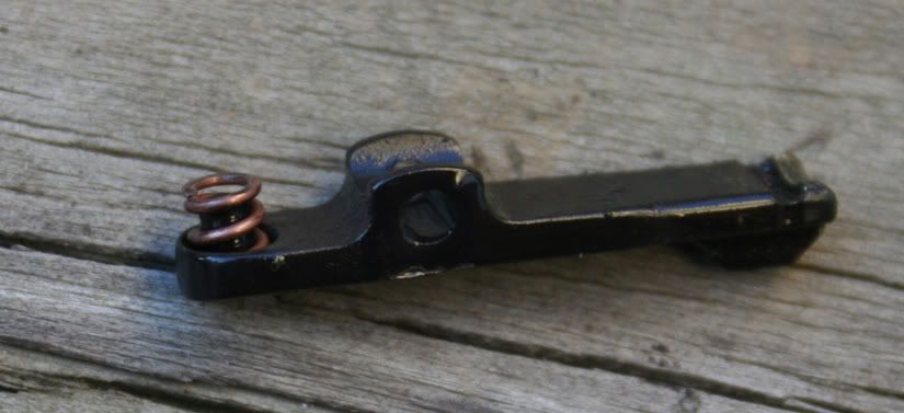

    ...I removed your rifle extractor spring and blue extractor buffer and installed a Colt gold extractor spring, Colt black buffer and a Crane O-ring.
    Later,
    Robb
    How can one tell a RIFLE spring? Colt GOLD spring? I'm not sure I have ever seen one that color...
    Any pics to show the differences?

    Quote Originally Posted by Rmplstlskn View Post
    Rmpl
    Rifle spring 4 coil. Carbine spring 5 coil.
    Rmpl
    They're actually bronze in color and come with a black buffer.
    This is the part number for the spring and buffer from Brownells. # 160-304-025 and they cost $6.69 anything with a carbine gas system you should use a Crane O-ring or a MGI D-fender extractor enhancer.
