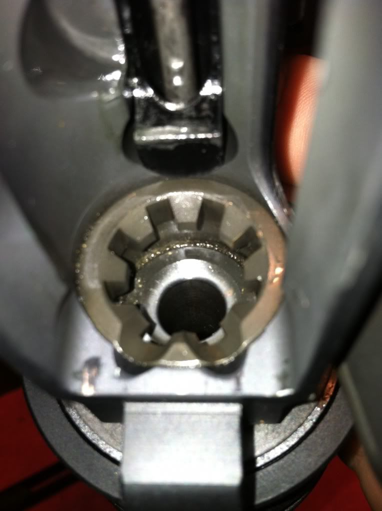

    which one of these look most like your feed ramps?

    I would have to say the M4 style feed ramps. This one is mine http://i263.photobucket.com/albums/i...imagecopy4.jpg

    does the front left corner of your magazine hit the upper? There's a suspicious looking wear (?) mark in that corner.

    I saw that as well and it looks like that may be where the round impacted in his receiver which is why it is pushed in so bad.
