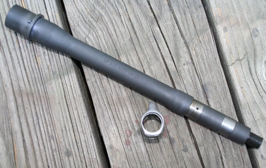

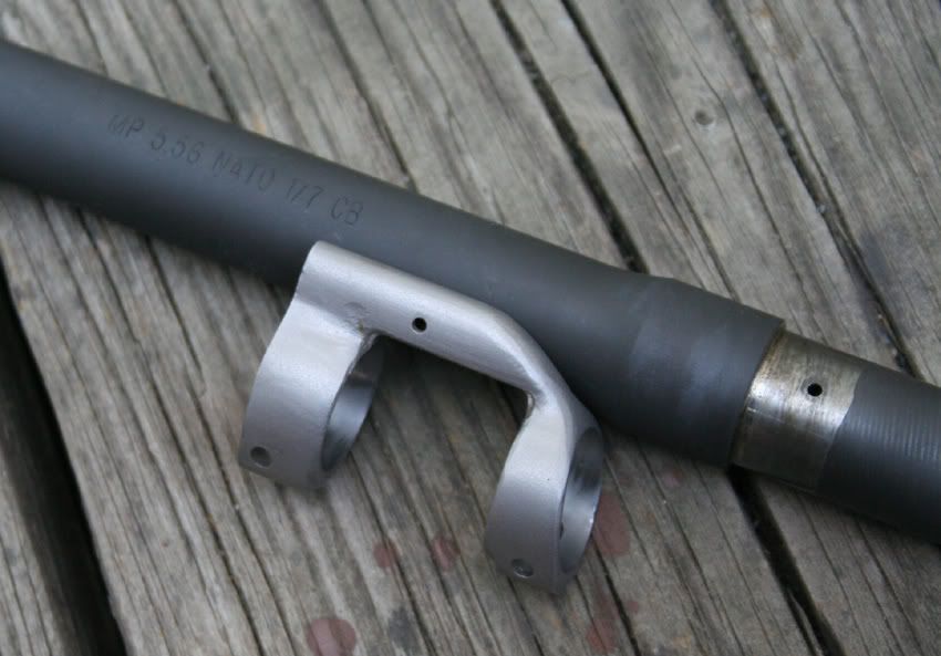

    ETA: 'shaving' a FSB is also an option, it's not the prettiest thing but it works. Here's two I've done (I've done many but only take pics of these two). Both are LMTs and will fit under LaRue or DD Lite Rails.
    refinished w/Norrels:
    refinished w/GunKote:
