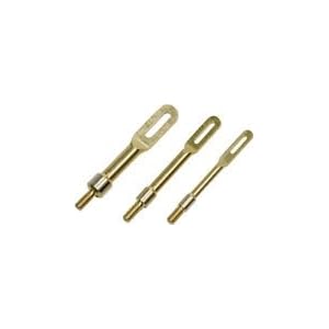

    and please do not use a tip like this
    they easily wedge between the projo and the barrel and are hell to get loose.

    Quote Originally Posted by Suwannee Tim View Post
    Not English, Southern I think. "Bloom, bloom" is Southern for 'bang, bang".
    Lol. I guess that's why I understood it.
    Yeah, good advice on the tip. I usually center up the hollow end of a cleaning rod on a stuck round, but you could just as easily use a brass jag.

    Quote Originally Posted by Tweak View Post
    and please do not use a tip like this.....
    I've never tried that. I'll try to remember not to. I have "push tips" which have threads on one end and a plain, solid, flat far end.
