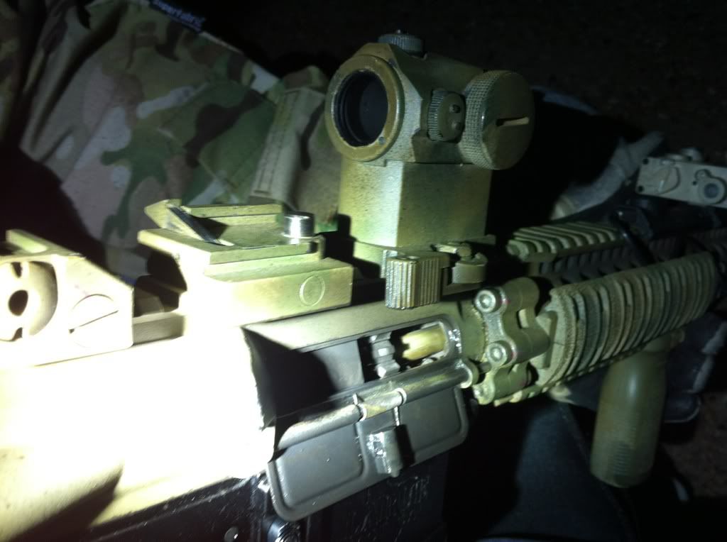

    Alright, so here are a couple pics from my and thopkins22's range trip the other night.
    This was the first time it happened that night, and it was after firing around 250+ rounds suppressed. It didn't happen while running my painted BCM lower (at least not that I remember) for the previous hour or so. We actually took a break and I swapped lowers to a Larue billet lower. But I'm pretty positive it would have soon because it was beginning to load REALLY slowly. But it did continue feeding when manually chambering. I just wanted to swap to another lower which had not yet been shot with a suppressed upper installed to see if the "fresh" lower would also start off great and quickly begin slowing down. And it did. I expect to have to reapply lube when running suppressed every 4-500 rounds, but the upper components don't seem to be the problem here (although I'm not saying something can't be wrong).
    This is a Larue lower and it was nice and clean and felt great at first. But after a few mags (maybe 3?) I could tell it was going to start having issues very soon, and it did. Note that I also reapplied lube generously to the upper's inside and CH and BCG before swapping lowers, as the Slip 2000 lube had burned off almost all the inside of the upper and the part of the bolt that is visible.
