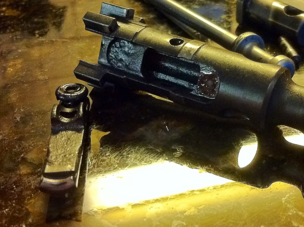

    2. BCM BCG with the black insert AND the O-Ring. I've been told it isn't quite necessary for mid-length systems, but went ahead and installed it on this particular one. Here's a pic I just snapped of the bolt/extractor setup just after taking it out for the very first time:
    Do you think using the O-ring could be an issue here?

    I would encourage you to toss that O-ring in the trash. Then tell us what happens. You absolutely do not need it with a midlength or most other AR's.
    I haveseen them cause numerous FTF issues.
    Roger. Done.
