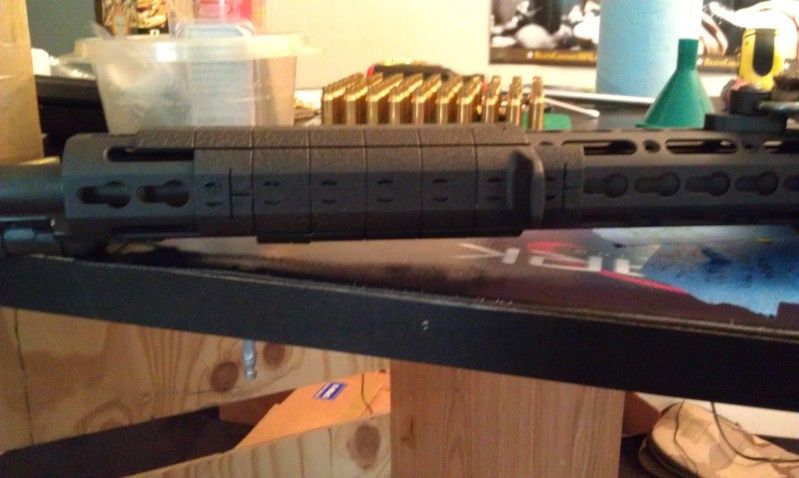

    Just got a set of the NSR rail panels to try out today. I had a very hard time getting them on. I was forced to file down the slits inside the keymod lug to finally get them to slide in. I don't see how they can go in unless they get filed down. Once they were on, they were nice...but the process of putting them on kind of put me off. In my opinion, I shouldn't have to file them down so much just to get them on.
  2. #622
    Jul 2006
    Oregon
    3,458
    The NSR panels are designed to be a tight fit, so they won't come off under hard use or be able to move around.
    It does require some effort to install or remove. The key is pushing the panel down while sliding them.

    I cannot for the life of me get these panels installed on this rail. What did you guys file down to make them fit ?
  5. #625
    Sep 2011
    130
    The little slits on each side of the lug on the underside of the panel.
  6. #626
    Nov 2008
    Northern Virginia
    716
    61 (100%)
    I tried shaving those down but no success. I think the issue is the little lug right behind the keymod is too wide to go into the slot.
    I tried pushing up and then forward and the keymod part goes forward but the little lug behind it is preventing it from locking in.

    FYI,
    If anyone wants to cut the one piece 7 section panel down shorter here is a tip. Take something similar to a dental pick and drag it relatively hard on the seam between the panels you want apart. I did this about 15 times on the backside only.
    Next place that same area over the edge of something like a table and press down on both ends. It breaks very cleanly.
    -Jax

    Got my panels today, two sets. They went on with a little effort, but no sanding or filing. Glad I ordered two, I don't see how you could do much with one set. They are really nice.

    Quote Originally Posted by SFCRoOKs415 View Post
    what kind of hardware is used on the attachments? Can we purchase just the hardware?
    Like the screws? They are a #8-32x3/8 100 deg flat head, T15 drive.
    The screw is staked on the end when it is assembled. They do not come apart to install, so you will not loose any or need spares.

    I got my NSR panels today, and I can see how some people could have an issue, But as Todd says press down as you push the panel forward..
