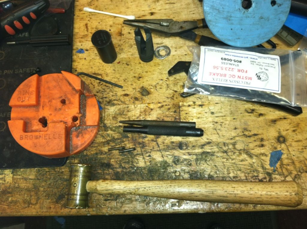

    For taper pins I use the pictures brass hammer and the two punches pictured. It's more technique instead of brute force.

    Hammer is on the red tool box, the heavy duty pin pin is just below the action block to the left of the 1/2-28 die.
    That's usually the problem with insanely tight pins.
