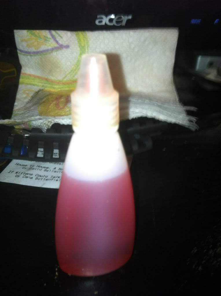

    Quote Originally Posted by sinlessorrow View Post
    i do a 50/50 mixture. what ive found best is to get you a little bottle that will fit in your pistol grip and fill it half way with oil and the other half with ATF, doing this will make 1 quart of each last you years, ive been on the same quarts for 1yr now and they still have over 3/4th the quarts left. it should look like this
    Thank you for clarifying the mixture. That sounds simple enough! Is that an old Visine bottle you are using?

    Quote Originally Posted by Terminator2003 View Post
    sure is i found the smallest one possible so it would fit my grip
    I lube with synthetic motor oil and my BCG looks like yours after 4-500rds. What advantage does the ATF add? Just curious as I have of others who use a mix rather than just oil.

    I like the bottle in the grip idea.. I'll look for a couple.. Mine probably won't have ATF in it however, FP-10 most likely. I do use ATF in my Toyota transmission.. works great.. Cheers.. Ron

    Quote Originally Posted by wahoo95 View Post
    Sent from my DROIDX using Tapatalk
    the ATF helps keep the motor oil from gumming up in cold temps, and gives it a little bit more lubricity to it
