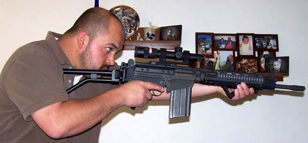

    Go with something fairly light if possible. I temporarily have a NF 2.5-10x32 on one of my FALs right now - it makes for a heavy mother, but it's been handy for checking the accuracy potential of a couple of 20" guns. Mine are "mostly" in he 2 MOA range with '91 Aussie F4 Ball. (Easy to do with 5 shot groups, less so with 10 shots.)
    The one pictured below is a simple Leupold 3x9 compact that works pretty darn well to 400 Meters (a 200 Meter zero lets me use the lower post at 400M - at 9x only). It's light and keeps the weight down and was easy to mount really low for a good cheek wield. Eye relief is long enough to mount in front of (vs over) the rear sight.
    Know that you may have to tweak the ejector to keep brass from hitting a windage turret - so bear that in mind when selecting a scope. I have done this on two of mine to allow use of the NF , but it's windage turret does not stick out as far as some.
    The newer Leupold 1.25-4 Patrol has caught my eye, but I'm concerned about the right side turret sticking out too far over the ejection port.
    I have a USO 1.5-6 Dual Focal Plane one the way - custom ordered w/o a windage turret - it will have a "zeroing knob" for windage, instead). Weight may be a problem here as well, but it will see some duty on a FAL or two before I decide where it ends up. They make this in a 1-4 also.
    3x9 Leupold Compact (rings have since been change to Seekins):
    Comp ML3 (on a now unobtainable mount) that permits co-witness with the irons. I love this setup, but wish my eyes were a little younger:
