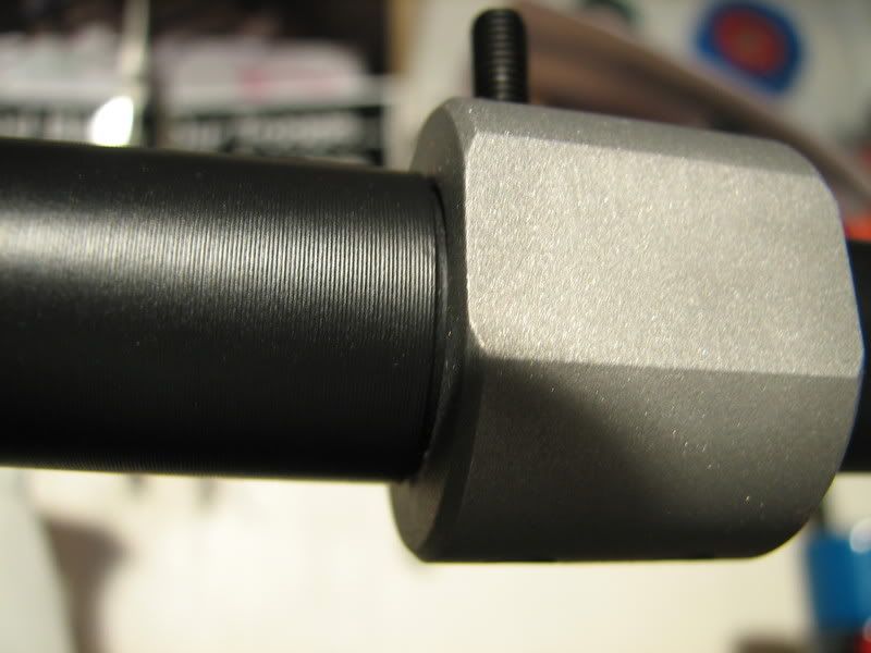

    update 1/24 pics
    Installed on barrel, centered with pointed set screw on gasport

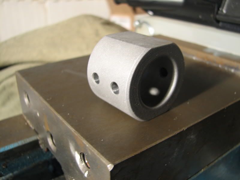

    Soft point screw installed

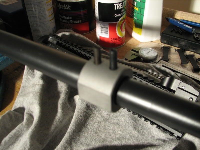

    Into vise, ready to drill.

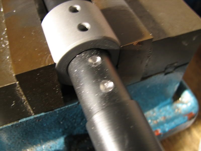

    Dimples started using jig, jig moved back to expose dimples, using soft point set screw to hold jig.
    Enlarge dimples to full 11/64" diameter, deburr with file

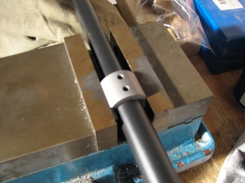

    Install gas block.

    Does a regular drill bit make the right "shape" of dimple for a set screw or is there an ideal mill bit that is used when dimpling barrels at the factory?
    Drill bits are for making clean holes, not dimples. From my experience, you can get a dimple that isn't the same depth at every point on any given circle centered on the dimple.

    Quote Originally Posted by SuicideHz View Post
    That's what SHE said...
    Standard drills are 118 degree point, the set screws are 90 degree.
    I see your points, I'm not sure how big of an issue it is. The idea of the tool was to locate the holes and align the gas port. I've never had a problem with a standard drill. A ball end mill may also work.
