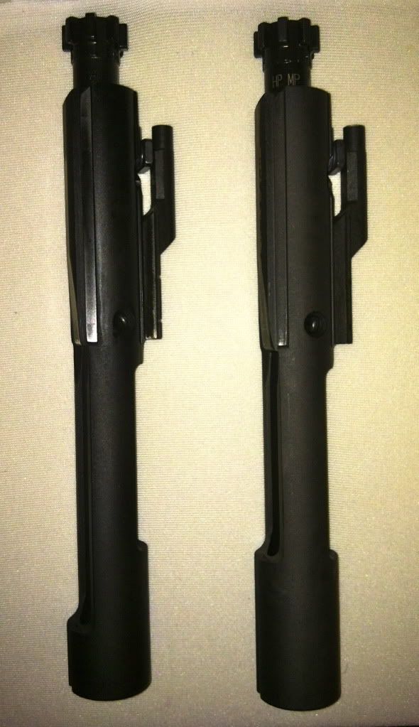

    Bushmaster BCG on the left, BCM BCG on the right. As you can see, the BCM has the "HP MP" markings on the bolt.

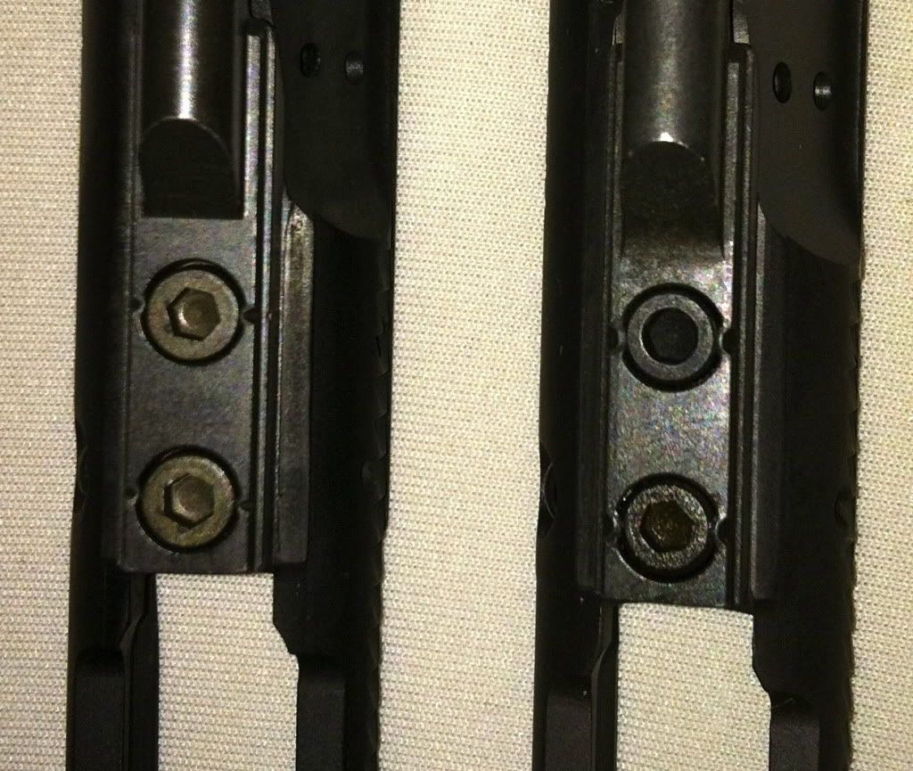

    Bushmaster BCG on the left, BCM BCG on the right. As you can see, the staking job on the BCM gas key is of a much higher quality. All four stakes are touching their respective bolts, prohibiting movement.

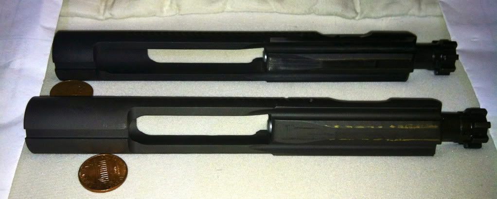

    Bushmaster BCG on the top, BCM BCG on the bottom. You can see the difference in the bottom of the BCGs here. Pennies were placed where the cutout starts at the bottom of the BCGs for comparison.

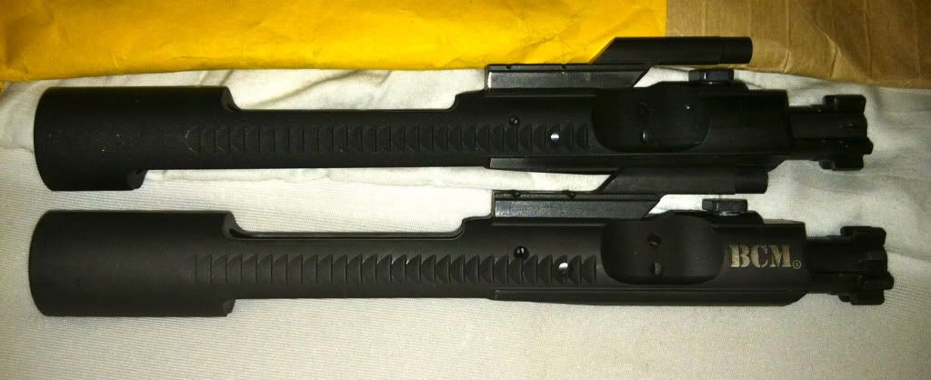

    Bushmaster BCG on the top, BCM BCG on the bottom. The "BCM" logo looks pretty cool too.

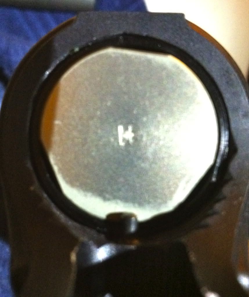

    LMT H buffer installed.
