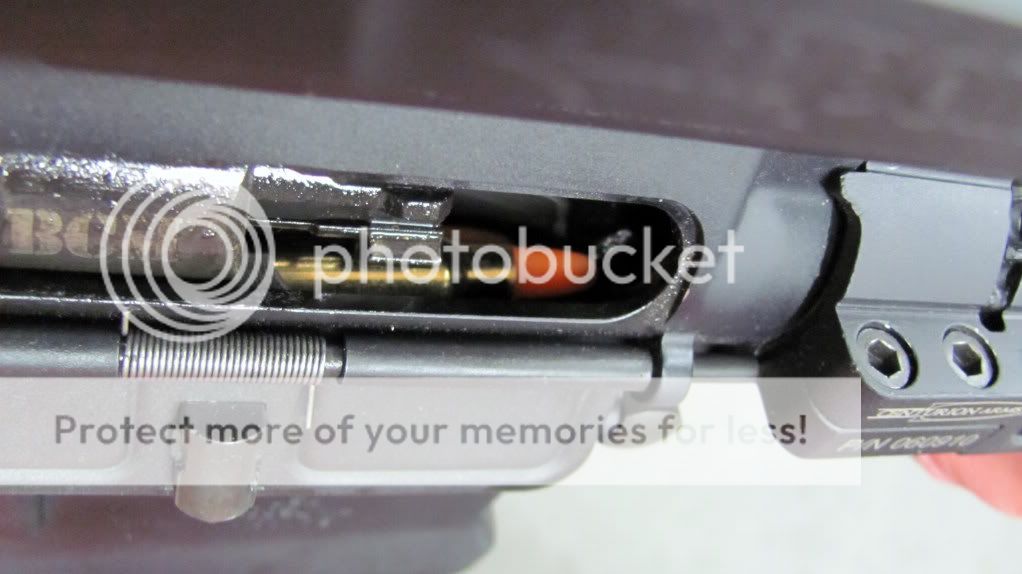

    Shot a carbine match yesterday and this happened to me three times with three different mags. All PMags. Approx. 75rds fired in the match.
    Racked the charging handle and the round went into battery.
    Short stroke? Mag overrun? BAD Lever on new Noveske lower?
    Specs on carbine:
    Gen II Noveske lower w/ BAD lever
    H buffer
    Blue Sprinco spring
    14.5" DD midlength
    IMI M193 ammo
    This only started occurring when I mated the new Noveske lower to the upper. I know...I know...I should have run it more prior to the match. Just didn't see this coming.
    My LMT lower with BAD has never had this issue with all things being the same. Buffer, spring, etc.
    I'll be pissed if this is a lower / BAD issue and it may very well be.
    I intend to take the BAD off and see what happens.
    If not the lower/BAD combo, what direction in buffer, spring should I go? Lighter, heavier, combination of the two?
    What is the experienced opinion of the house?

    scoby, i'm having trouble seeing everything in the pic. are you saying that when you charged the weapon the bolt DID or DID NOT strip a round into the chamber? if i'm reading your post correctly, it sounds like the weapon chambered the initial round appropriately. if that is the case, when this malfunction occurs, does the spent casing get extracted/ejected? have you noticed the bolt locking back after the last round?

    Kyle, you're right....should have clarified this.
    It happened once on a mag change. Hit the BAD and the bolt didn't catch the round.
    Happened twice during firing.
    Each time I checked the chamber, saw what happened, worked the CH and continued.
    I'm thinking the BAD, but don't know.....yet.

    haha... no problem. so it WAS extracting every time, just failing to chamber the subsequent round, right? and was the round that failed to chamber still completely seated in the mag?

    Quote Originally Posted by lethal dose View Post
    No extraction problems.
    The round looked just like what is shown in the pic. The round was not completely seated in the mag. It was like the bolt never picked up the round and ran over it but, pushed it forward just alittle.

    A lot of different issues going on here so you will want to minimize everything.
    First, load one round into a mag. Fire. Did the bolt lock back? If yes, do it ten more times and see if it does it every time.
    If it does not, put a regular carbine spring in the gun and try the test again.
